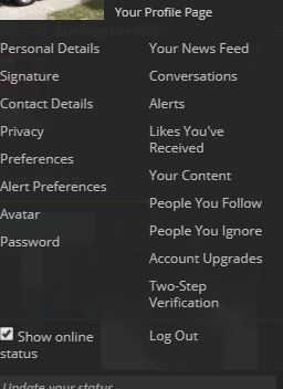

Forgot I was trying to do that. I don't see my sig on my own posts. Is that normal?
U gotta go in there and make it and save it first: Click on yer name top right, see below.
topsig.JPG TOP of forum: click on yer name then:
Click on signature and then go to town and then save at end...
