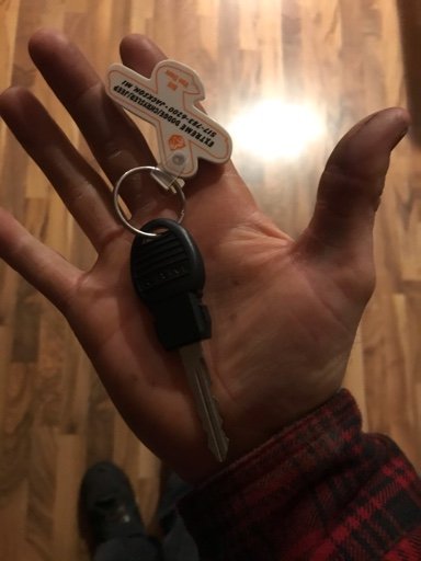

FYI, not sure if it matters but this is just a standard key9302ebf8ce3e1872093476ec5b6cc06c.jpg

Regular key. No fob. For some reason this tradesmen did not come with a key Farb just a regular key that I have to stick in the door to unlock it.
Not sure maybe there’s some kind of chip in this key....?

Just tried to post a picture again. Look further up in this thread and you can see you have a standard key. Apparently I’ve reached my “cap” on the number of photos I can upload with “Tapatalk free”

Even the old style key key has a chip in it starting 15-years ago roughly.
