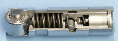

Take a look at where the most common failure is with the valve train, can any other components stress the roller?

Supposedly FCA is on its 4th different version of roller lifter according to a thread(https://www.ramforum.com/threads/does-the-5th-gen-5-7l-have-the-dreaded-mds-lifter-issue.166285/) see post #10 that was on here within the last couple of weeks. I had the cam/lifters go out on my 2015 with 32K miles roughly 3 years ago, replaced under warranty, switched to Redline 5W30 now around 80K miles, no issues since. I haven't heard of any VERIFIED cases of anything newer just conjecture. If FCA did improve the lifters and eliminate the problem the tick might still be there as was the case with the 3rd gen Hemi which also had ticking problems but not to the point of being anything other than a nuisance.
