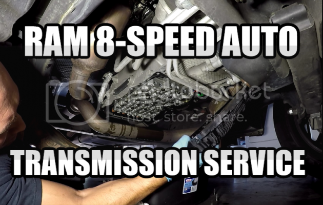

Glad you confirmed not being able to get all of the oil out of the trans when dropping the pan. I heat cycled my truck several times just to make sure when I did mine too!
I agree on either using ZF lifeguard 8 or the Ravenol fluid as this trans is unique and my fluid was still pretty clean after over 90k miles.
Thats funny about Shawn's EcoDiesel fluid I totally agree. He says in his video how he has changed it several times when he was at around the 150k interval. Why did he need to keep changing it this often and why it was so dark each time leads me to think the same theory that something is wearing quickly in his transmission.
Here is a link to my DIY video for anyone tackling the job themselves! :D
https://youtu.be/mNo9Ln5KrOE
