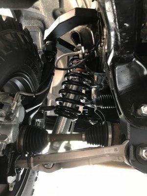

The 4” kits have a 4” top spacer to “make up the space” provided by the longer knuckles and drop brackets. The 6” kit uses a 5” top spacer combined with an approx 3/4” thick preload spacer that requires the strut to be disassembled and inserted just above the coil and top mount. This is how Zone and BDS get 6” on the basic kit. So if you have a lift kit and Bilstein front struts you discard the preload spacer and just adjust the preload on your Bilsteins to your desired setting. When I had 5” rear coils I had my Bilsteins set at max, when I switched to 3” coils I adjusted the Bilsteins down to zero.
The 5/3 setup should leave you with a measured rake of about 1/2 to 3/4 depending on your stock measurements.
Here’s a pic showing the preload spacer from the Zone instructions.

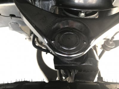

I removed my Zone UCAs and went back to the OEM UCA, they only had a few hundred miles on them when I had my lift installed. If you look closely you can see 3 tack welds on the BJ top/UCA, I had a friend do that because I hear some owners BJ’s work loose. Not sure if it was needed but it gives me peace of mind.

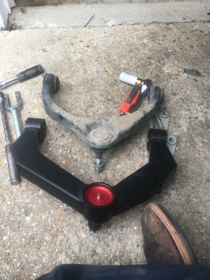

I hated to get rid of them. They would have bolted up, but the added length would have given me a wider front track width than I wanted. They really aren’t meant for stock trucks or in our case lifted trucks that the knuckles correct for the lift/drop brackets.
here’s a comparison pic
