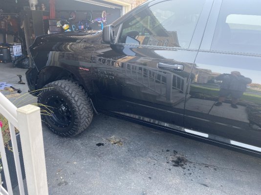

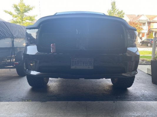

Annnnnnnnnd she’s done. Made a fancy breakfast for the kids. Got them bathed and ready for the day, cleaned the downstairs of the house and managed to install half my body lift. I also managed to get my ass to the beer store. Hence the can for celebratory reasons... also, I’m on COVID vacation so there’s that. Thank you so much for those that responded. Shadow, I owe ya a beer

Looks GREAT!!! And thank goodness you restocked your beer supply!!!

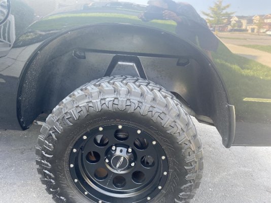

need some good side before/after shots, but I'm still happy I did mine. Congrats on a job well done!

Thanks man!
Hey, another question. It says for the rear body mounts to use the small washer ?!? I used the stock gig flat washers with new bolts [emoji2369]

does it fit? You should be fine.

Yeah it fit... I’m just wondering if maybe the new bolts don’t go in all the way. You figure they would have just sent two longer bolts [emoji2369]
Another observation. I didn’t move my spare winch and I can still lower Ana raise it lol. It’s not ideal but saved me some time

I think I remember using all new bolts for the lift, but having to reuse the washers.
