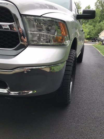

At that width it would be a good idea. A 0 offset 20x9 would be my choice unless you wanted a bit more out. I run a -12 offset which gives it a bit more push out. Have been eyeballing a set of methods with a 0 offset to pull it back in about 1/2” from where it sits now. But I’ve also been debating on going to a 17 instead of the 18x9 I run currently. Pictures is my 305/70r18 on an 18x9 -12 offset

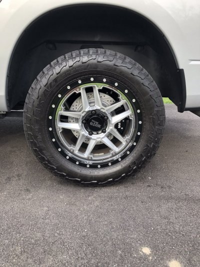

Love my wheels…actually accent my truck. Silver is almost a dead on match. I can get them in a -18 I think…

Well I had a chat with MotoMetal, my wheels were discontinued so my chances of finding my set in a -18 are nada. I shouldve bought the set with the offset. So I called Bora and chatted with them. I was concerned about the wheelcentric aspect of the spacer. We know the hub is 77.8, but my wheels hub are 78.1. That is less than third of a mm. Negligible difference, concerns alleviated. Ordered a set of 1.5’s. My wheels have stud pockets, so now grinding studs. I will give them a shot, but I am eyeing a set of 20x12 wheels. Main goal is to get some space between the inner sidewall and the upper control arm. Ive always had a rub on the sway bar, might cure that too.
