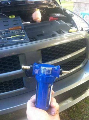

I made my catch can with compressor separator from home depot works well and was under 30 bucks. You can't see much of it so need for fancy bullet unless you have the cash.

Here is what he used (Not my truck)
Look in the compressor, air tool isle. I used a Huskey for a while but didn't like the plastic bottle so close to the manifold.Smiley,
I looked in Home Depot and didn't find anything that would work. Can you supply a picture?
