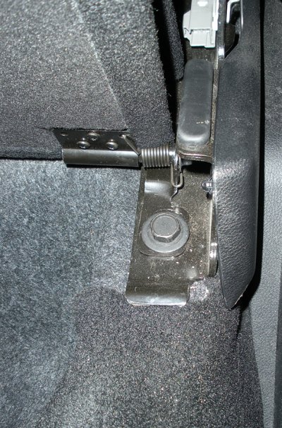

Here is the floor, installed. Split floor, for Split seat but works, just fine, with a solid seat.
I really like having the two hard plastic "legs" that can be flipped out to support the floor.
The hold down strap works great too. No flopping around or noise, whatsoever.
To install, simply remove the Bolt, that secures the back seat itself.
See it, from Passenger side, rear door. Here it is

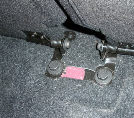

In the middle, since I did not have a split rear seat, I had no bolts to remove. But, I noticed that there was a cutout, in the carpet. Removed the cutout and there were my two wholes, with nuts underneath, already welded to the cab, just waiting for my to buy a couple of bolts.Which I got from my local hardware store.
Now, if you look at the picture above, you see there is an extra hole, above the bolt, where it looks like another bolt could go in. Uh uh. No hole in the floor board for it. MEthinks it is a guide pin. There are guide pins, on each side of the seat I do have.
Here is the drivers side rear door view and the bolt that holds the seat, in place, simply remove, put your floor in place and reattach the bolt.
