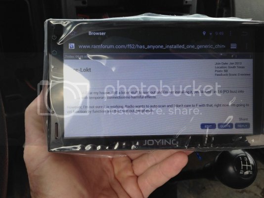

Testing Wi-Fi at my house. Still a lot of stuff to sort out and I'm not installing it, yet. Moved pin 14 (PCI bus) into harness with temporary connection-no harmful effects.
However, I'm not sure it is working. Radio wants to auto-scan and I don't care to F with that, right now. I'm going to vet function by function and then sort out peripherals.

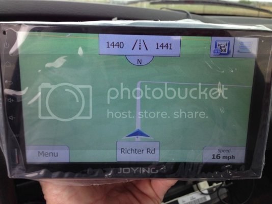

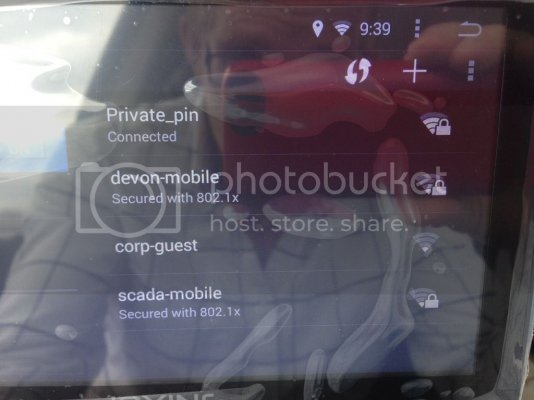

Okay; here's some pictures. This is the Home screen. It's animated, and the default. There are other animations as well as the option for your own picture or something downloaded. I need to find where the Dodge Ram logo boot screen is, or where to get it, but that can wait for final install.
Wi-Fi was set up in my driveway ~50' from my router. So, I'm reasonably happy with the signal.
This is when I composed the post above.
Viewing the post on RF.
Here is iGO navigation. There's the option of Sygic and these HUs support Google Maps-and from reading, some think that's the best option. Didn't update the included micro SD card with latest maps. IIRC, iGO updates free maps every three months. I like the option of offline or online navigation options.
Joying includes an 8GB thumb drive, and I put a few songs and videos on it. I accessed it through File Manager, and album art didn't show. I've read whatever external memory you use with Joying radios (and probably the others), you need to format it via the HU. I just copied/pasted with it in my laptop. So, maybe that's why album art isn't displayed or the method of accessing?
IDK if a video will show, but I have a playback clip. Through the harness I referenced in an earlier post, the ground theoretically goes to chassis. I drove around and watched this-you'll probably recognize this video of some cholos trying to burgle a store. I chose it because it's pretty short.

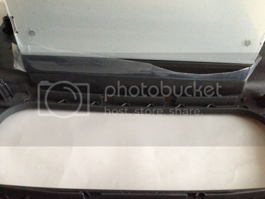

This evolved from a question about radios to basically a DIY thread. So I'm going to put up some more pictures that might benefit others.
I used the Metra bezel. Others have patched their stock bezels/opened them to size or used a Weedahoe bezel. http://www.amazon.com/Metra-95-6522B-Double-Install-2002-2005/dp/B00KQ1JJA0%3Fpsc%3D1%26SubscriptionId%3DAKIAILSHYYTFIVPWUY6Q%26tag%3Dduckduckgo-ffnt-20%26linkCode%3Dxm2%26camp%3D2025%26creative%3D165953%26creativeASIN%3DB00KQ1JJA0 Right now, that's the half-harness, FAKRA antenna adapter and bezel for $29.99-a heck of a deal.
It's not the best picture, but here you can see how the JY-UQ128 is exactly the size of the lip around the opening on all sides. I think on the JY-UQ124 you'd only need the short sides relieved.

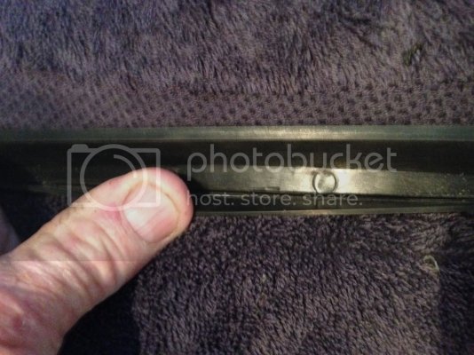

I used this plastic cutting tool rather than a Dremel. It's ~$5.00 at Lowe's and more controllable. Basically, I just cut right around the outside of those opening lips.
Here's a good picture of what's removed. The edges cut pretty clean with this tool if you re-sharpen, but I still needed to do a little sanding.

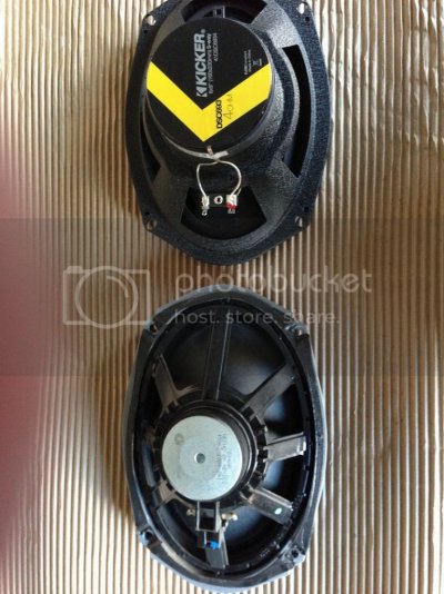

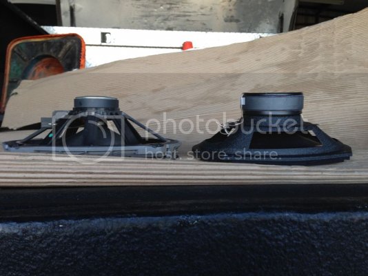

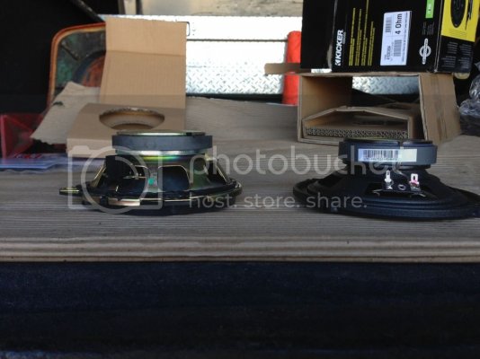

Might as well post some speaker pics. This is good reference to see what stock versus aftermarket looks like.
Front 6X9s, from top. Those are DS-series Kickers front and back. I think that's a step up from their economy models but no means their best.
Side view. The magnets are noticeably larger on the fronts, and the speaker is deeper. It might fit the door, but you'll see the frame is different and won't fit the existing hole.

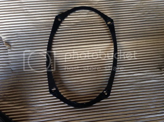

I asked for spacers and got these Scosche ones included. I had to cut them out to ~1/2" margin to allow for the pointed corners on the speaker. Only two diagonal points work with the existing holes, so you'll have to drill your own.
Driver's door installed. Actually, I did this while the HU was in transit.

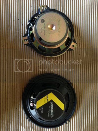

Rear Quad Cab speaker comparison. These are closer in size, if not specs. A couple of new mount holes is needed. but nothing else.
Side view.
