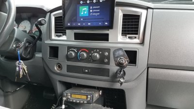

well, I have it installed now. a Xtron Tr108

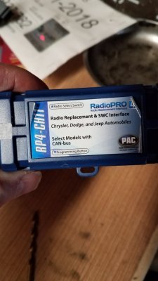

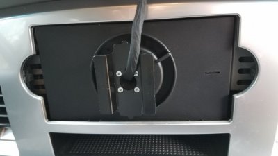

Pleasant surprise, kinda. I found this attached to the aftermarket pioneer. I wonder if they ripped the customer off saying he need this or his steering wheel had to be replace, I see no controls on it.
no cutting involved!!!!

I like the radio so far. however I am not sure yet if the home/pwr/vol places light up. Its kinda necessary at night. It is possible I missed a wire. I definitely need to get the steering wheel controls working then it wouldn't matter. So I need to get a wheel that has the buttons.
cons: home/pwr/vol are not lit(maybe). supplied mounting bracket only attaches with one screw and you need a spacer on both sides, it doesn't quite reach the stock mounting holes on the dash.
pros: no cutting bezel. sound is decent. big beautiful display. Maps work either sygic or waze. Wifi works great too.
