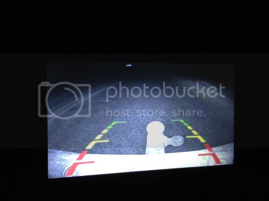

I replaced the reverse light switch and the camera works fine. The camera function overrides whatever is on the screen. It doesn't affect booting, either.
I took this picture to see what the IR lights would do for illumination. I can't notice much difference with lights off or on; I might tape over the reverse lights and see what pure IR illumination offers.
You'll notice in this picture and the one in daylight there is a difference in guidelines. In Settings (think it was Settings-Other Settings) there is an option for the HU to display them. As it was checked, I had two sets of guidelines. The Pumpkin Auto camera has no ability to disable lines, which is unfortunate since the Joying lines are the wider of the two. Interestingly, there is a setting in the HU for trajectory reversing lines. I'll look into that more but think the camera itself doesn't have that feature for the HU to support.
Clearly, I'll need to adjust it and get some known distances calibrated. I am going to take a break from this for a bit before the dongle attempt. I'm also considering re-flash with a custom ROM, as I like some features others have incorporated in builds.
EDIT: Think the line values are ~2'/4'/8' to farthest respective color lines. Aimed/measured at my track height and camera orientation, anyway. Actually 18" to leading edge of hitch. Reviews in Amazon state the retention screws will rust, so put some sealant over them.

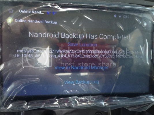

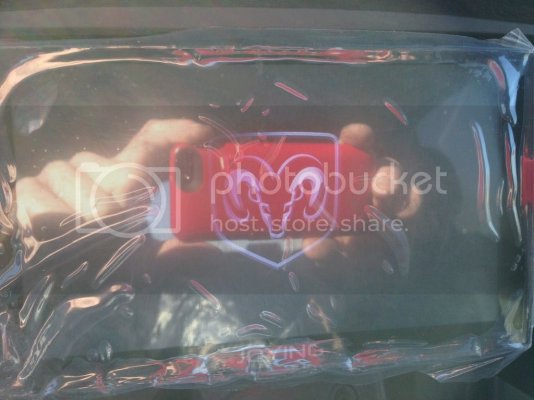

I re-flashed with one of the custom ROMs out there. That's something each person with one of these radios needs to decide if they want, and which custom ROM or make their own. The Joying ROM is fine, but limiting to me. Of course, that simplicity might be what others want.
So, for those that are interested, here's a few steps of the process. First, back up and copy your factory ROM in case something bad happens. There's a few apps, but I'm familiar with Nandroid. Titanium is great, though. Open the back-up app of choice and decide where you want to save it to.
Next, copy the custom image to whatever media your HU accesses. I chose the GPS card and took the opportunity to load it on a 64GB card (max. supported size; again, format as FAT32 on something this size).
On a Joying JY-UQ128 (research your particular model processor and screen size when looking for custom ROMs), you press the recessed Reset in the face and hold it a few seconds and release. That'll bring up the Recovery menu, and on this particular radio the prompts of selecting (VOL+/- or PWR) don't apply. You have to do it all through the Reset; short pushes to scroll, long push to select. And you'll start by wiping factory settings, then reboot again in Recovery. Select the option to install/wipe from (in my case) SD card. Then, it should start running the install.
Ignore the "failure to mount" at the top. However, you might need to repeat the install/wipe again.
So, what do you get with a custom ROM, if you're unfamiliar with the concept? More options and tailored apps are the biggest pluses. Factory ROMs sometimes won't allow apps or recognize devices. And every time you cut power to the HU, you lose station pre-sets, where in this ROM there is the means to retain them. The best feature of this ROM to me is PC Radio is already on here. I've never cared for the canned music and overly broad music genre of SiriusXM, and this is by far a better option, if one has bandwith access. Also, I'd like to revisit the SWAC settings as I may try that again-but not for a long while.

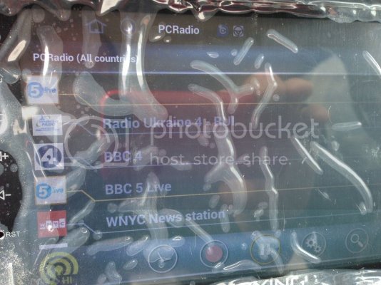

These are some of the offerings in the News/Talk format. There's genre of pretty much every type, so it just means some poking around.
This alone made the root/ROM worth doing, and likely will facilitate the dongle. Again, I'm going to leave that alone for a little bit, as I'm a little burned-out. And I still have to re-download all my GooglePlay apps and reconfigure everything.

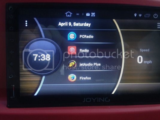

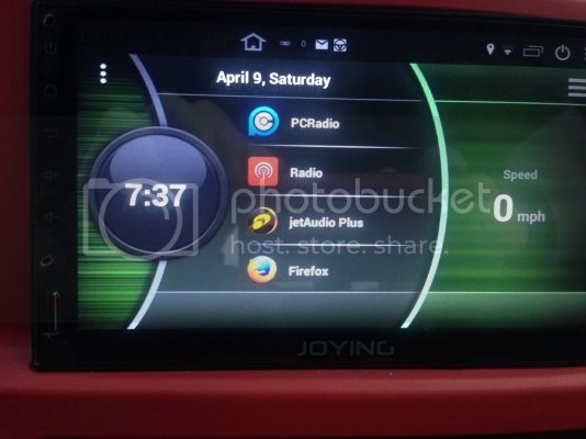

I was going to hold off a bit for an update due to a pending ROM release ~April 15, but I'll post some stuff now.
Most of my time since last post has been reading up on stuff, since I left Android four years ago. I've done one custom ROM update since last post and overall, things have been fine. But this last week, I've been having a lot of issues with the HU shutting off/re-booting/starting apps. I *think* I have it solved in that I disable some stuff within Xposed Module and PCV Startup Builder. I believe it's Car Launcher, a new home screen included in this ROM mentioned. If I go back to, say, Joying or Klyde launchers, Car Launcher will pop up and start a music service which isn't activated because it won't currently support my player of choice-JetAudio. Seems like stuff is sorted, now. Hoping that the next ROM may have some better integration/activation of stuff.

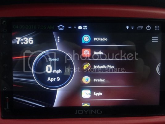

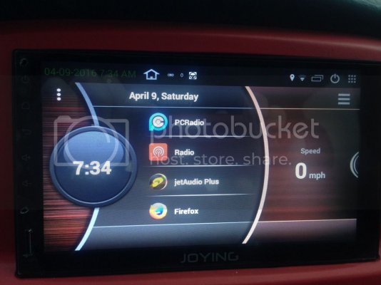

So, Car Launcher..it's a much more sophisticated-looking home than the Chinese ones. Here's some pictures you can reference against earlier photos.
Car Launcher Home Screen Type 1
Car Launcher Type 2-Red
FYI, here's Car Launcher Type 3 in three other colors.
This is Orange. I know, it looks brown. In fact, this looks like wood grain.
There is currently no way I know to change widgets on these, so speedometer/clock is all you get. Speedometer uses GPS, and there is a trip computer as part of this. You can change values (Metric/English) and will also note cumulative miles driven while HU is on. Not sure nor care if there's anything else.

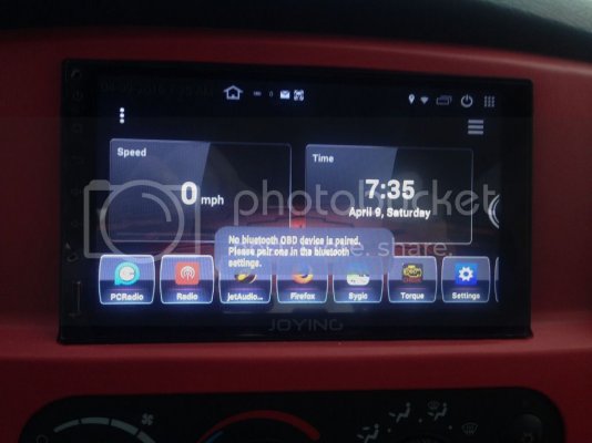

I spent some time on the dongle. I got this 3G CDMA dongle, in spite of everything I read only mentioning GSM-type.
Well, I didn't have much luck in getting it going, even with PPP Widget. However, I have since learned that 4G stuff generally works fine-sometimes with dongles, it's not a sure thing and searching PPP forum will have lists of known compatible dongles. But the good news is that a hotspot works fine and isn't going to need extra fussing with. Hotspots set up within connectivity settings in Settings.
I'm still trying to find out what Bluetooth OBD II interface will work with this. Purportedly, if an OBD II interface isn't named "OBD" or "OBD II", it will not interface with HU in turn meaning Torque app won't be able to read information. I believe I came across an Xposed module that lets you rename some interfaces, although mine does show "OBD". Nobody ever replied to my thread on Torque forums about one that is known to work with Ram/ChryCo vehicles.
Otherwise, I've been reading up a lot on MTCB HUs and getting back into the Android ecosystem after abandoning it ~four years ago. Maybe if they had "pure Android" phones like Nexus back in the day, it would've meant people would've stuck with Android.
But to that end, I made my first apk-a live wallpaper.
I didn't have the volume that high in my pickup, so sound is pretty quiet. If you click the video picture to see it, you'll need to turn the player volume up, as well as probably your computer. The girl is Koneko Toujou from High School DXD and the music is from a indie cover of a theme from the Touhou Project games.
The takeaway from this is that if you flash a custom ROM, you'll likely have periodic issue with apps playing well with each other and in some cases abandoned development. You will necessarily get informed, if not outright educated in order to keep up with things.
You'll see in these pictures I now have Sygic navigation. I've come to find out that probably all the HUs with iGO have some sort of tweaked pirate version that I guess uses a key generator. It doesn't seem iGO is compatible with these HUs, as Naviextras/Basarsoft doesn't list them as supported. I believe there is iGO Primo for Android phones, but I'm not for sure what's the difference between that and iGO (probably platform, I guess) and if iGO Primo would work.
Oh, I understand there's wireless keyboards that will work with these HUs. They're probably 2.4ghz since they're not BT-supported on these HUs. A Logitech K700 is known to work. I may get one and if I do report back.
