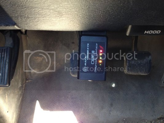

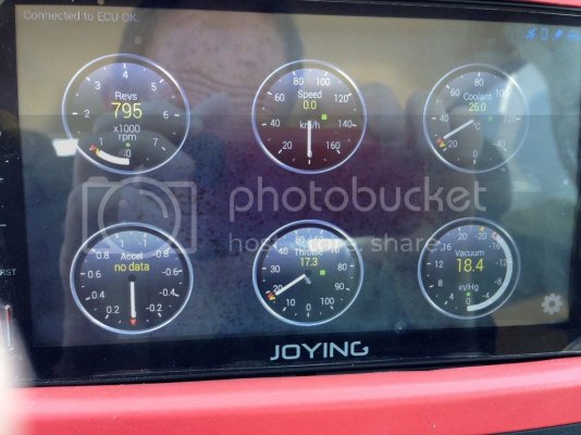

A small yet big update-Torque Pro is now functional. I got the BAFX OBD II adapter because it specifically stated other (cheap blue ones) adapters had trouble with SAE J1850 protocol. I also saw on Joying's blog that ScanTool adapters didn't play well with these units. Also, somehow on this custom ROM the Bluetooth MAC address wasn't showing, but worked by manually-entering it.
Pretty big, but leg room is fine.
This is a cold start panel reading.
I still caution anyone considering one of these generic HUs to do their due diligence. But after five months, I'm quite happy with things. I've got internet, navigation, 250 GB of movies and music, PC Radio for Sirius substitute and a fairly decent means of productivity with Autodesk360/WPS Open Office/mouse & keyboard.
Still trying to solve the SWAC situation and will update periodically. Otherwise, I think this topic has run its course. All the 3G Ram-pertinent stuff is here for anybody interested in doing this, along with the good and bad.

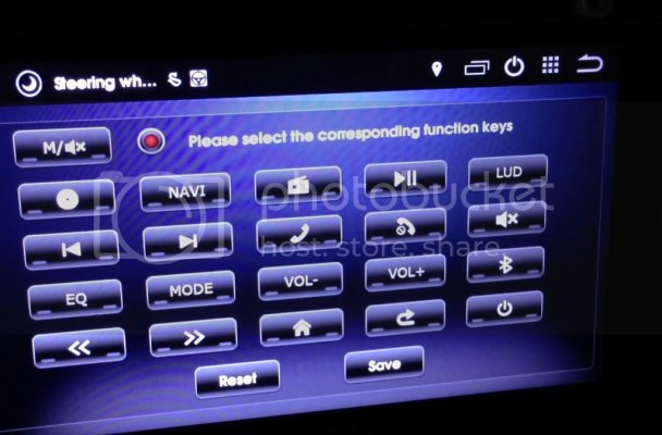

I looked everywhere for instructions to make Axxess SWC interface to work with Joying HU. I didn't find anything.
I also have a Joying HU, the same as you. The difference, I bought directly from Joying, not from Amazon. I don't have a RAM but a Ford, but I decided to create an account on this forum to let you know I've just succeeded to make it work (almost, let see why later).
No more suspense, interface has to be set up manually to Metra-OE and brown wire to KEY1 to HU (Brown/White is discarded). That's it. As the manual says.
Metra OE: Connect the steering wheel control Key 1 wire (Gray)
to the Brown wire.
Now let me tell you my story :)
I didn't buy the AWSC-1, but the Axxess BX-FD2.
BX-FD2 harness is a mix of 3 products: AX-ADBOX2 & AX-ADFD01 & AWSC-1.
I wrote to Axxess to ask them what was the difference between the 3 parts and the BX-FD2 and they replied it was the same but their tekky guys prefered use the 3 differents parts as it was easier to troubleshoot.
So because of the price, I chose the BX-FD2 combo.
Like you, I tried every combination and I gave up. I wrote to Joying. By the way, they did replied to me quickly each time and they did not help.
After reading your post, it gave me hope (the line where you said somebody made it work with another brand). I told myself I had to try to setup manually the interface to Metra-OE once again.
According to number of flashes, my unit was detected as Alpine by the interface. I tried several things to set it up manually but learning did not work at all. I think all this time, I messed up the sequence and did not set it up correctly.
To set it up correctly I did:
- Unplug the main plug to shut down the interface.
- Replug it (don't put the key).
- Wait for the interface to finish its first sequence. (You can count number of flashes, I had 7)
- When the LED goes off, put the key and turn it to ignition.
- Then follow the instructions to change the radio type.
If I have a comment to say for instructions, I would change #4 et #5.
4) Press and hold the Volume Up button until the LED goes solid, then
release. Repeat this step for the desired radio number you have
selected.
5) Once the desired radio number has been selected, press and hold
the Volume Down button, on the steering wheel, until the LED goes
solid. The LED will remain on for about 3 seconds while it stores the
new radio information.
In my case:
#4: I didn't have to hold the button. I just have to press the Volume Up and the LED switched on. When I tried to hold the button, the sequence did not complete. The LED stopped to switch on.
So I pressed normally the Vol+ 11 times.
#5: I pressed the Vol- but the LED switched off as soon as I released the button.
Then, go to Settings > Steering Wheels Keys and start to learn the keys.
On my steering wheel I have Vol-, Vol+, Prev, Next, Microphone, Phone, Media, Ok.
I could learn only Vol-, Vol+, Prev, Next. All others still remains connected to it Sync. (Ford speech Recognition system) - except media. It let me switch between sources. Radio Sat 1, Radio Sat 2, Radio Sat 3, Bluetooth (connected to Sync, not the Joying HU).
Prev and Next do work to change Sirius stations though.

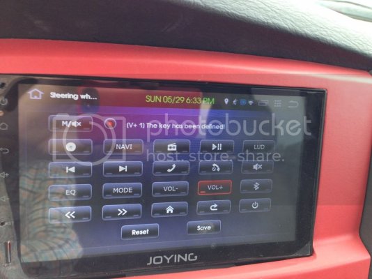

After two new members joined after seeing this thread and offering help, I gave it another try. I disabled CANBUS Service, seeing as I don't need a running process that doesn't affect me. I tried to get the HU to learn, but no more luck than before. Next, I tried the suggestion of eliminating the SWAC chassis ground and connecting that to Key2. Nothing. However, I touched that to a chassis ground and got the first part of the learning function
Function defined.
That isn't fully learned, though. So I remove the wires from the chassis ground and it learned the function.
Here's a really crappy 35 second video of trying out the function. lol, I've got the camera upside-down and trying to look at too many things at one time to keep it short.
Joying%20SWC%20Test_zps2i6hunwq.mp4
http://vid1119.photobucket.com/albums/k623/Opus_Dei/truck/Joying SWC Test_zps2i6hunwq.mp4
The wires are off the chassis ground when I start, to mimic an unpressed button. I slip the ring terminal over the screw and the volume starts running up, as it would if the button was steadily pressed.
Clearly, with both the SWC ground and Key2 to a chassis ground, it is an interrupted process. Breaking the ground allows the process to happen. However, it won't do this through the buttons themselves. Additionally, the HU still only learns one function.
Joying has a video where they use a test SWC with three leads; one to Key1, another to Key2 and a third to the HU harness ground. We simply don't have that many wires to work with on 3G Rams. Additonally, having pin 14 in the factory harness running through the MUX behind the instrument cluster doesn't lend itself to modding.

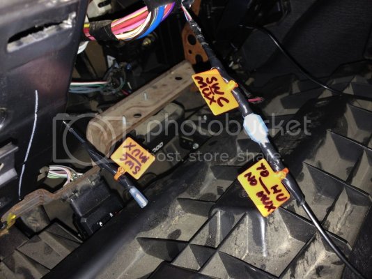

SWAC are now working! I'm not entirely happy how I did it, but I'm OK with it. It is fully reversible and not some hot ghetto mess.
I'll start by saying that my truck didn't come with SWAC. I added them based upon a tutorial on DodgeTalk. If you DIY, you'll remember where they connected at the base of the clockspring/column. If your 3G 2005< truck had SWAC and you want to get them working this way on a generic Chinese HU, the wire colors likely aren't the same. However, at the mentioned bottom of the clockspring/column, there are two connectors. One is yellow and one is white. The white one has the SWAC ground and lead to cluster. You'll have to determine which is which.
Long story short, I knew the SWAC switches had two leads each; there's a red/black and a red/yellow to each button with a splice to a single lead to the clockspring. With a common circuit, logic says the resistors in each switch have different values.
You can clearly see the two pins of the switch. The switch looks a little butchered, but again, the parts were sourced from the DodgeTalk thread and others modified them that way to make it work. When I put them in, I used a couple of dabs of hot glue to keep contact with the harness plug. It's soft glue and easily removed. It might not need it, but JIC...
As mentioned, those leads fed through the clockspring and used two leads for the circuit. I decided to cut the wire to the cluster and crimp some spade ends to restore the wire, if ever needed. The ground to the dash frame was left as-is.
The BL/BK wire goes to the MUX..maybe C4. You can see where the RD/GN grounded to the dash frame. There's still a piece or two of friction tape from when the harness was bought and disassembled.
I made a "Y" harness to bridge the MUX cable to the HU harness. The intent was to go with one lead to Key1 and the other to Key2. There's no need to differentiate them since the resistance values of each switch determine the function you assign. I crimped the three ends together and soldered/heat shrink the splice.
I tagged each of the three ends so there's no mistaking which goes where if I want to restore the wire.
The video is ~2:00 and shows the programming and testing. Unfortunately, all my settings were wiped out from leaving the battery disconnected overnight. I'll have to get all that re-established.
These are tentative settings. I assigned VOL UP/Phone OFF/VOL DN to the right switch and radio presets up/down and Phone ON to the left. Additionally, there are tweaks via Xposed modules (only rooted/custom ROMs) that allow mapping buttons to apps. I think Spotify was one I saw mentioned. Also, there is supposed to be the ability to add functions by long or short presses of the buttons. I don't know that I care to do that, though.
Anyway, everything is proven to work with specific details on how I did it. 2006> 3G trucks seem to fare a little better in that PAC or Axxess modules seem to work for SWAC, given CANBUS. I may still try for USB-3 and if I do, I'll report on it. Otherwise, thanks for reading. :favorites13:
