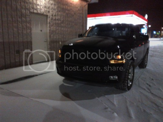

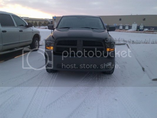

My only disappointment with my 13+ projector heads was the LED's
are only half as bright as 13+ Rams that came with them factory.
...Plus I had mine murdered out by JJ
and the tinted LED lens made them even darker...
Adding Amber Demon Eyes helped a little but still not bright enough
unless its totally dark out, but then I need my low beams on.
From the looks of brguzz's video the LED's go to full flash brightness as DRLS
At first I thought I could just run my park lamps to get the same thing...but not to be...
my park lamps in about the same lighting conditions
When its brighter out they are barely visible
I desperately needed a fix, right now my DRLS are my high beam bulb at half power
(for my canuck ram's DRLS) and looks dumb so I just turn my low beam HID's on ALL the time.
