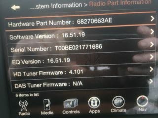

2017 RA4 vp4-NA (verified / USA)
Courtesy of @RebelChief 's new ride.
Pn: 68270661Ax
SW: 16.23.21
Courtesy of @Banjo 's new ride.
Pn: 68270661Ax
SW: ??
Is this what you're looking for?
The part number on my 8.4" RA4 is 68270661AE
@MPgrimm2 here is my screenshot from my 2017 Ram 1500 Sport Crew Cab
------------------- Canadian ra4's ----------------
2017 Ra4 vp4-CA PN courtesy of @TeraNewf 's new ride
Hope this is the info you were looking for
2017 Ra4 vp4-NA (verified/ Canadian)
PN: 68270663Ax
SW: v16.51.19
