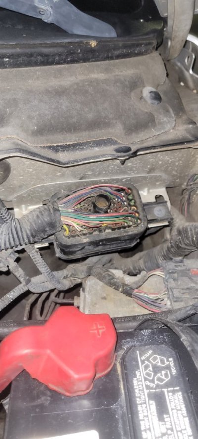

Once fixed everytime i turn on the truck or go to crank im hearing this clicking noise like 3 or 4 clicks. Its not the relays turning on its coming from the bulk head connecter on the firewall right next to the battery. (Image attached)

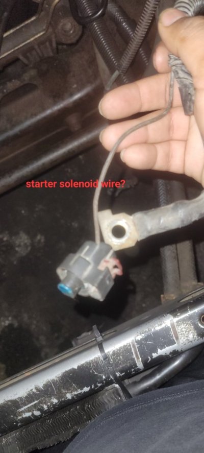

I was also testing for 12v while cranking and using my multimeter to check the starter solenoid connector (image attached) and was not getting 12v to it.
