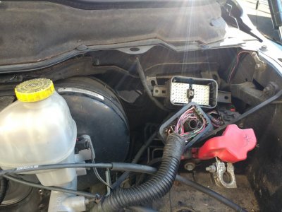

The hardest part is the wiring period. I'm currently in the middle of doing the same thing with an 03 quad cab. Go look under your hood on the right side by the brake booster and see if you have the c130 plug. If you do then I might be able to help once I get mine finished
