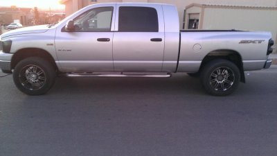

so im wanting to do a cam job on my 08 mega cab 4x4, im wanting to do a cam, springs, rods and lifters, and im gonna put shorty headers and true duals when i do this any ideas on the best set up, and how hard will it really be, ive done a couple cam jobs on a couple Chevys, but never a hemi, will it be any harder or about the same? any help would be much appreciated thanks
