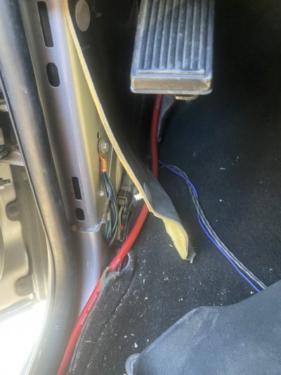

Wonderful well I figured this out a little bit ago. Something dumb and just completely overlooked. Just one of those things I suppose.
So the driver side kick panel there is a ground bolted to the body, there are possibly 5 or 6 ground wires all black and green with a weird crimp, not one I’ve seen before but looks like a very bad design. Anyways the wire was just sitting on the outside of the connector and that’s where my issue was. Kinda wish I saw this before I posted it but hopefully it may help someone in the future so that’s all I can wish for.

Yea pretty much exact same boat. Until I found this ground that was loose. ****** connector from the factory but as soon as I touched it my interior lights turned on because it knew my door was open at that point.
