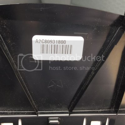

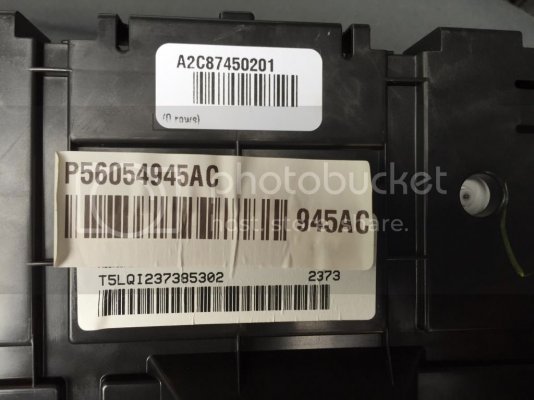

I dont remember who asked about the part numbers for the cluster but here is the pictures of the stickers on this cluster,
the last 8 numbers in the Vin are: ES152929

Diesel Engine Clusters -
1. 56054694AB [JAT, [JDC] -- Unknown
2. 56054695AB [JAT, [JCB] -- Unknown
3. 56054696AB [JAX, [JCB] -- Unknown
4. 56054697AB [JA6, [JDC] -- Unknown
5. 56054698AB [JA6, [JCB] -- Unknown
6. 56054699AB [JAX, [JDC] -- Unknown
7. 56054700AB [JAV, [JCB] -- Unknown
8. 56054706AB [JAV, [JDC] -- Unknown
9. 56054699AB [JAX, [JCB] -- Unknown
5.7 and V6 Clusters -
1. 56054939AB [JA4], [JCB] -- Unknown
2. 56054940AB [JA4], [JDC] -- Unknown
3. 56054941AB [JAT], [JCB] -- Unknown
4. 56054942AB [JA6], [JDC] -- Unknown
5. 56054943AB [JAX], [JDC] -- Black & Sliver (120 MPH) (RAM LOGO)
6. 56054945AB [JA6], [JCB] -- Unknown
7. 56054946AB [JAX], [JCB] -- Unknown
8. 56054947AB [JAT], [JDC] -- Unknown
9. 56054959AA [JAV], [JCB] -- Unknown
10. 56054962AA [JAV], [JDC] -- Unknown
56054945AC is a Black with silver rings that was paired with a 5.0 radio originally
Also need to know the Radio size, Logo on the top of the cluster, and MPH or KPH.
Same part number as the one above, would be nice to see if they change any.
Do you know the Logo or MPH/KPH
Hopefully, we can get that list populated, should make tracking down the correct PN easier for everyone.
Rherman1
May 9, 2014
476
51
Sunny Florida
6.7 Cummings
Could you be a little clear on what you want exactly? Ram on the top of the cluster, My pictures of the cluster are up at the top of this post!
