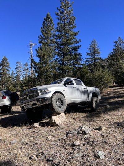

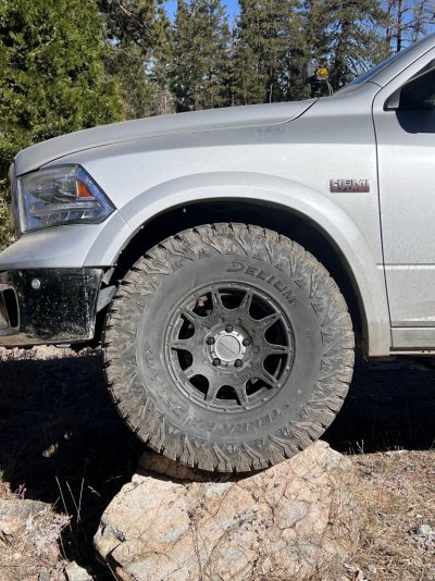

Hate to bring this back @ram1500rsm and @Harley1200
But realized im also i Socal, and basically have your copy cat builds!
Im also running 37x12.5r17 with a 0 offset up front, (my wheel and tire combo is 96 lbs!) i have ironman full suspension, (supposed to be 2.5 up front, 2inch spring in the rear), after seeing your photos i think i may have more than a 2.5 lift up front. Is there anyway you guys can post a hub to fender well measurement so i can figure out, i had stock airride before and deleted that, without taking measurements(because it popped) .
Thanks in advance!

I'm messing with my current setup and pulled numbers off a stock truck today. CCLB was the truck.
Hub to fender +/- .25"]
20.5" front
23.5" rear
20.5" front
23.5" rear
Thank you so much for this!
Im going to have to remeasure when i get home, Im only supposed to be running 2.5 inches of liftup front, so this will settle that

So what i found was,
Hub to fender front:
~25 in
ground to fender front:
42.25in
Hub to fender rear:
~ 24.75 in
Ground to fender Rear:
~42
My tires measured out to be 36.2 on the truck, my spare measures out to a true 37
So im assuming that puts me at about a 3.25 lift up front which would explain why my down travel is so bad.
Im currently running Ironman Suspension that i did a full Air ride delete with, they are completely garbage. I threw the coils on without messing with any height, and they have it preloaded extra on a 2 inch spring so much im at more lift than advertised (both set of front struts are like this) i broke a set already.

For comparison with my icons, gladiator 2" coils and 34s I'm at,
23" +/- (1 turn preload over icon setting)
Hub to fender rear:
24.5"
Ground to fender is arbitrary as our tire sizes are significantly different.
How much down travel do you have with this setup?

In the rear, im at about 9.5-10 inches of useable travel, i can get another 2 inches if i disconnect the sways, and disconnect the shocks, with the coils still pretty much in their resting place, but loose. So definitely gonna go with longer shocks. I have all Metal cloak rear end from a gladiator besides the ironman shocks and springs.
In the front im not too sure how to go about the measurements.
Im running Ironman 4x4 foamcell pro, they have 15.9 inch springs(or about 16) compressed down to 13 inches, so down travel im at about 3.5 inches, and up travel alot less because the bump stop is in the way. Im wondering if lowering the preload they have set will really allow my front end to get the advertised extended travel
Watchinf some videos on youtube of another silver ram on 37’s, testing BLD. He looks like he has exactly the same travel I have up front. Im assuming these 4th gens are just starved of travel up front.

Measuring up front is tough. I usually go off the specs listed for shock travel, then doing my best to measure it at ride height etc. With springs installed it's pretty much an educated guess. If I'm being lazy I'll measure shock length at ride height and from top of tire to fender, then the same at droop and compare.
2" is the minimum down travel specified by king and fox IIRC and I believe the more ideal setting is 2.5" or more. So it's a balancing act. We are starved for useable travel, especially in low speed scenarios. I can say my icons are noticeably worse with a couple turns of preload. I've personally settled on 1 turn more than factory and have adjusted my rear to make it aesthetically appealing to my eye VS raising my front more. Icon also runs 650lb coils so they are rather stiff and become harsh with alot of preload. Also....be careful at full droop. At full lock my CVs kiss the ears on my Icons. I'm on like set 4 of cv shafts and I'm looking to replace them again.
Are you running stock front sway bar links? @ram1500rsm was able to squeeze extra travel by using different links. I have a set of newer extended Smaxx links so DM me if you need a set.
The rear in these trucks is easy to squeeze some pretty good travel out of which is cool. And the fronts will cycle around 10" of total wheel travel, but in order to use it about 2-2.5" lift is about all I can see being realistic before the ride likely sucks.
Post 298 in ram1500rsm build thread he shows a 1/2 gain in up travel with longer links. Fyi
