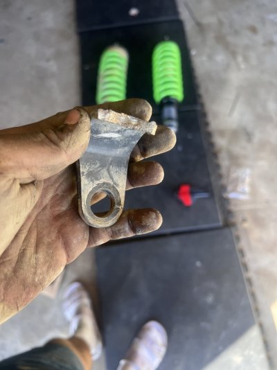

the issue i had, was the lower shock mount broke in some light desert offroading. I was with a group of subarus. While they are pretty capable(I used to drive one). The fact I broke something doing the same thing, and they didnt pissed me off.
When i contacted ironman(unlimited mile 4 year warranty) they have taken their time to get me replacements. Thankfully I already had my old set, that they had set replacements for because they have an internal squeak. They have yet to send a new set for the broken ones. For being the “strongest shocks on the market” I sure tested that, and they definitely dont back their warranty.
As for the BJ, they gave me a brand new set of UCA’s, their previous sets for all models had a nationwide recall for premature failures. This new set has Moog BJ’s and the articulation is already far greater than the old set.
Im going to figure out a way to strengthen that Lower mounting point, and then i should be good until i can fork out some money to start all over with new suspension, since they wont warranty anything, and my truck just sounds like a squeaking nightmare front and rear.

That shouldnt just snap. They either have them way underbuilt (dosnt really appear to be) or something is not right…like the bumpstops need to be longer and you are using your shocks for bumpstops instead.

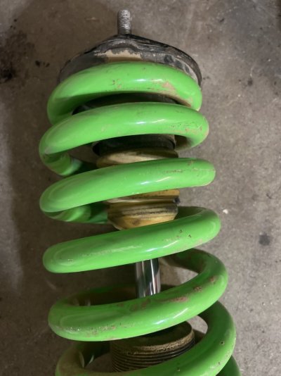

Yeah, the bumpstops are about 3-4 inches long. I believe it may be preloaded too much
The other attributing factor, i believe, is all longer travel struts have a spherical bearing up top, and that connects to the tophat, i.e King, Icon, Fox, Carbon. The tophat is fixed for mine. And with the travel being so much, i feel like it was too much for the shock, if you see the photo with them together, the tophat is off centered, and the entire strut is bent.
Not to mention, all those brands, also have some sort of bracing on the top portion of the lower mount, to help strengthen it. Im

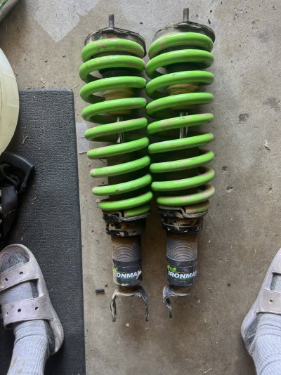

I also do still have the broken suspension, but i have the previous set that they originally sent with internal noise on the truck now.
Im most likely gonna go to Carbon shocks, or just pick up whatever cheap set if struts I can find. For now the Ironman will Suffice, as it gives me the travel for the slower stuff. Anything with slight whoops probably will snap the lower mount again…

Both the broken suspension, and the one on my truck now measured out to be exactly the same. So im thinking of just lessening the preload how ever much will be a half inch for our trucks. My 37’s would still clear at full bump, and ive done all the grinding necessary already.
