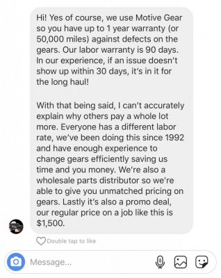

0F2652B4-D4F6-47E6-909D-56CEA0AEB40B.png 289AD0A7-07CE-4875-B4D9-0CF469245B5B.jpeg So I am contemplating regearing my 2018 ram 2500 6.4 to 4:88. But $2500 or more is expensive!
I found a shop in Los Angeles on Instagram read the message that they sent to me and tell me what you think $1500 for both axles seems too good to be true?

I don't see where it says it's for both axles so be sure to clarify. Also, it says their regular price is 1500 and this is a promo. So, is it less than 1500? Hell, for that I might drive to LA from Oregon to have mine done :)

Sounds too good to be true to me. gear kit alone (with bearings etc.) are probably ~$1200 give or take
They mentioned they are a wholesaler. So maybe I get the parts for cost and they just make the labor?
50,000mile part warranty and 90 days labor.

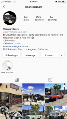

I definitely here what you are saying. I’m 2hrs away from their shop. They have been in business since 1992 so they must not have screwed up to much?
