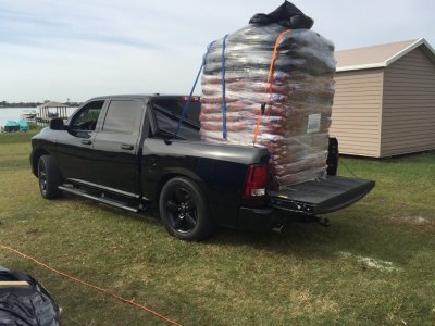

john94si
Aug 5, 2014
182
33
I drove with this a few miles from lowes.. i estimate 2800lbs.. that's what bump stops are for.
mtofell
Mar 18, 2014
2,648
2,293
I'm actually surprised they loaded that for you.
X2 - It's only a matter of time (and lawsuits) before Home Depot and Lowe's start checking truck ratings and only load accordingly. I was at HD once and the manager frantically came out asking the loading guys about a truck that had just lost a bunch of plywood a few blocks from the store. It turns out he had loaded it himself and the guys remembered he was nuts. Something like 50 sheets of plywood in a small truck.
