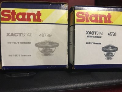

E4083D64-F7C2-4805-A454-61D81A3F39BA.jpeg Stant thermostats from summit racing. I was running the 190° for 6 months no problems before switching to the 180°
180° 48798
190° 48799

There's a few guys running even lower then the 180,i have a 170 in my truck,and the Miledon high flow 160 is fairly common with the guys running their trucks hard. I run a 180 in my wifes stock untuned 2016 Challenger and like it,around town at really low speeds,the car runs basically the same temps as it does with the OEM 203,but as soon as the cars moving,it drops down to 185 and stays there.I run my 170 with no issues even up here in Canada,truck runs perfectly fine even at colder air temps.You can get away with running a 180 even if you're untuned,just leave the stock mechanical fan and shroud in place,and you'll reap the benefits of the 180 t-stat.The stock clutch fan even when it's disengaged still moves enough air to keep the truck in the vinicity of 185 with-out having to have a tuner change the e-fans parameters.For the guys yelling about there trucks not running any cooler while towing,that's to be expected,but nobody tows constantly,the rest of the time,the truck runs around unloaded,and won't be maxing out the cooling system.
