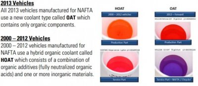

No HOAT is what was used in pre-2013 model. From 2013+ they use a special blend of OAT and can't be mixed with anything but water

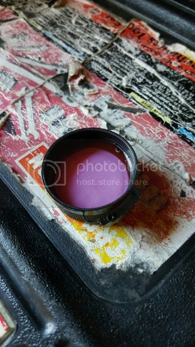

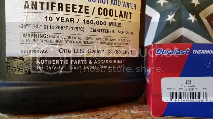

Just get a gallon of premix at the dealer, ask for the "purple stuff" You will not lose more than a galon. I have the AZ t-stat. Its in my shed, ill grab the part number in a few. I think it was 12 bucks or so

"If a customer chooses a different type of coolant than that which was originally in the vehicle's cooling system, the cooling system should be flushed to remove all of the old coolant. This will avoid any potential incompatibility issues between IAT, OAT and HOAT coolants. We have not heard of any horror stories of bad things happening inside a cooling system when different types of coolants are intermixed. But antifreeze suppliers caution against mixing different types. Their advice is to use "same with same.""

I just got the Duralast 4127. They didn't have the 4128. Will I get any DTC from getting the 170? Anybody have issues with this thermostat.
