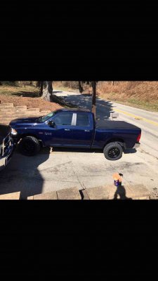

Yes, I have .
Wish I could load up better pictures but I cannot figure it out lol

Tpearson515
Jul 12, 2016
218
79
Saco, Maine
Do you have to get brake extension or anything
No, a ground strap extension on the driver side front in the wheel well and that's about it, cleaned up with a wire wheel to confirm good contact and painted. Everything else has plenty of clearance frame barley shows with a 1.5 so I didn't need wheel well guards. Also the exhaust tips I just tipped up a little.

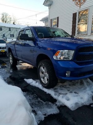

ChelseaB
Mar 3, 2017
30
11
I have a 2015. Just last weekend I did the supreme suspension 3.5" (really is 2.5") spacer in the front and a 1.5" in the back. I put 33x12.5r20 and I haven't had any problems with anything so far! It was super easy to do too. IMG_7369.JPG
