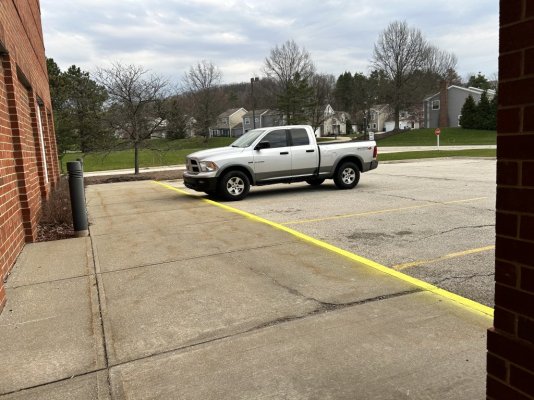

I just recently bought a 2009 Ram TRX4 with the 5.7 hemi. It seems like a great truck but I got it real cheap and it has a few issues.
First issue is the 4x4 doesn’t work. Previous owner installed a new switch in the dash but it doesn’t do anything. No click or sound just dead it seems.
Second issue previous owner had issues with the KEY and replaced TIPM module and fuse box under hood. Now the fuel gauge, oil pressure gauge don’t work. I can read the oil pressure and fuel level with my scan tool tho and it’s okay. Doesn’t the tipm need programmed to the truck?
The third issue is the fuel tank straps but I see it’s a recall. Will the dealer fix that free?
Also when I get into top gear it seems to make a funny sound but I think that may be the MDS thing shutting down cylinders. It’s weird feeling. Can that be deactivated somehow?
