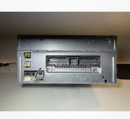

I know it’s an old thread. Checking to see how it went. I have a 2011 ram that had an aftermarket radio in it. The build sheet states a 730n. I purchased multiple ones and they all do nothing except show the dodge start screen and then nothing. The connectors have all match up.
Any help would be appreciated
Thanks
Dave
Thanks
Dave
My first thought is these radios have two different communication speeds, referred to as a low speed or high speed bus. Do you know what type of vehicle the radios came out of? This thread has some more info,
Or post the part # and i can let you know what speed it is

*P05091656AC* Is the number on the radio
Yep, that's a low speed for a Chrysler 200, Dodge Avenger, etc., won't work, need one from a Ram, T&C, Caravan, Wrangler, Nitro and a couple others I can't think of at the moment
