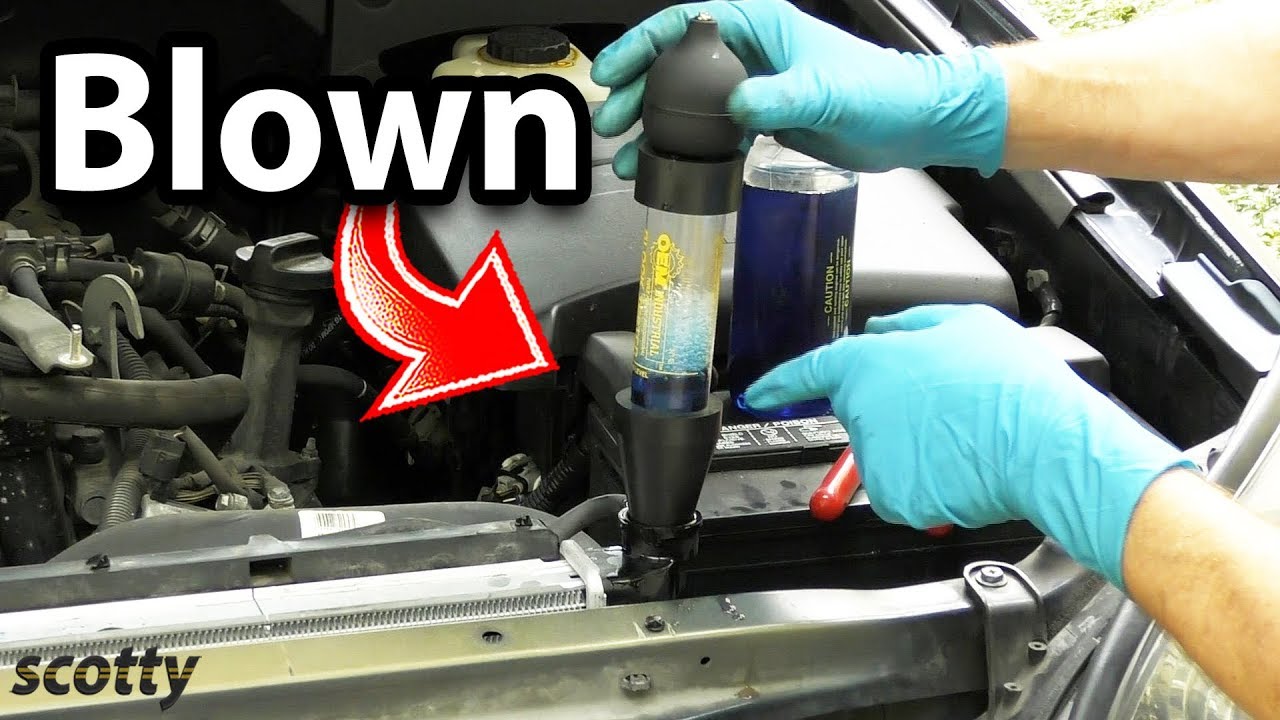

They do have ways to test for combustion gases in the coolant - this will tell you if you have a crack/leak in any of the combustion areas (head gasket, cylinder wall, etc). If there isn't any combustion gases then the leak is most likely in an area that the oil and coolant are close to each other (oil galley/block area, maybe some gasket area) ( I haven't been through a hemi block to know all of the passages.
Read this - the combustion gases part is at the end.
or try what scotty shows
