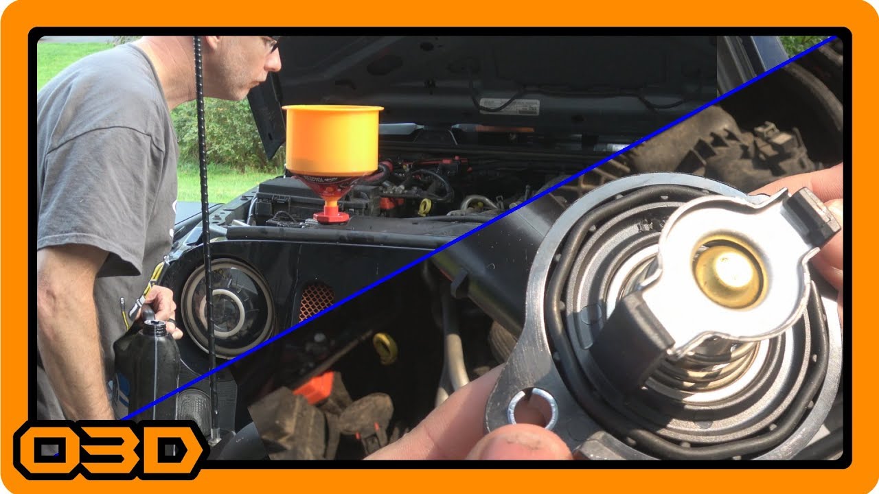

To my knowledge no, you can't just bleed the air as you need to fill that space with something else (coolant). I see people use kits like this that either sit on top of the radiator or the burp tank, but in our case you would do the radiator. You start the motor with some coolant sitting up in this funnel and whenever an air bubble passes by in the radiator this thing will force new fluid it and you can see the bubbles rise out.

+1 on this for the OP, great pic. I just did a coolant fill on my 2018 after replacing the shattty plastic oil cooler unit and used the setup in rzr6-4 pic. You can get them at harbor freight for less than $30 with their never ending sales.

Jeep bleeder, using the fancy bleeder funnel
