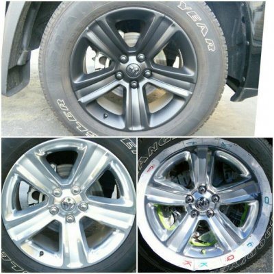

2014 CCRB Plastidippiage
xXAvroArrowXx
Feb 18, 2014
199
56
2014 Ram Sport CC
Backed right out
Sent from my Nexus 7 using Tapatalk

Super easy and cheap. Wal-Mart and Menard's I've seen have started to carry PD in store. Menard's in particular has a big variety in stock. My local store has black, red, yellow, green, glossifier, smoke, and camo in rattlecans.
If you use a hairdryer to dry between spraying coats it speeds up the process as well. I can spray an entire wheel in about a half and hour to 45 minutes and have it completely done.

Did you tape it off or remove the tires?
Sorry for the late response, I'm not on here as much as I used to be.
I just put plastic grocery bags behind the wheels to cover the rotors, a socket over the valve stem, and then I started spraying. You can take the wheels off if you're a perfectionist but it's much easier overall to just leave them on.
Protip: Shine your tires before you spray and when you're done spraying the wheel the overspray that gets on the tires comes off extremely easy.
