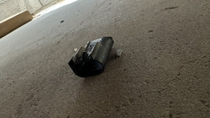

How can i order tan panal i broke both boots driving throw loss sand can i fin it through part number?

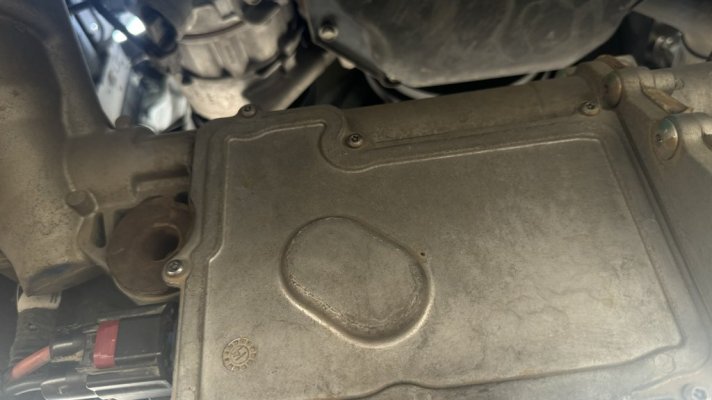

I do have more pictures. I gave it to the truck driver who delivered the replacement from the yard. It's from a place called South Florida Auto Recycling, and honestly it's too large to stow away and not very useful for anything else. The first set of pictures are from the 'black' Cardone rack, the gray rack pics are from my original vehicle. You can clearly see the difference. Mine had water exposure but it was more subtle the Cardone rack is filled with calcium and other nasty stuff from the stagnate water.

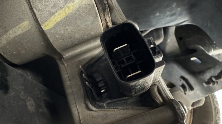

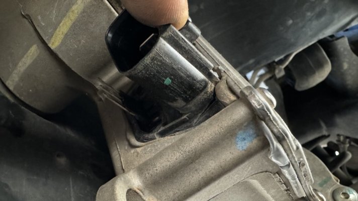

How can i buy only the circuit panal i broke both pin boots hopefully i can fix it my self buy put new one in and ceil it in good please help

Are the connectors still ok to the board? Just glue that outer plastic piece back on...

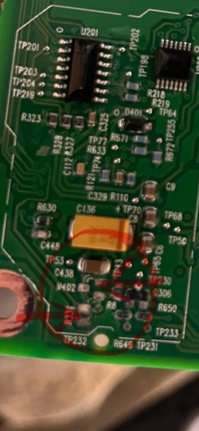

v7tech, do you or anyone else have a picture of the resistors on the back on the circuit board? I’ve got a guy willing to attempt repair on my board but I have 2 resistors missing and need the numbers. Any help would be appreciated! IMG_5307.jpeg
