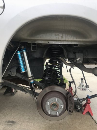

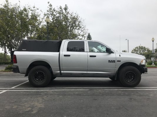

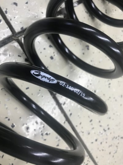

Got the springs installed. They're so damn long i had to compress them about 1.5" to fit them in. even with the trackbar disconnected drooping the axel in full won't unsettled them lol. I could have tried to loose the rear control arms but i didn't want to mess with them. Other than that they drive just like the Icons so the ride is plush. They got me around 1 3/8-1.5" lift rear went to 41.5", i'll imagine that will be 42.5" if i didn't have any weight in the back.I'm expecting they will settle some with miles. Axel is centered so i didn't have to bother adjusting the trackbar.
Haven't decided yet if i'll do IBP's or normal smooth body Kings 2.5 foor the back, the more i read about the IBP's the the more i'm inclined to think having regular shocks with an external hyd bumpstop is still what i'd prefer to have. the needle to push the IBP and the size of the IBP is space that won't get the same amout of oil, I think with Kings i'll have go with a 3.0 body shock to compensate, then the issue with tuning the valving with the knobs. i've had CDC before with Icon and was excited to play with them for a week after that i never touched them again.
I have a couple of phone calls to make tomorrow then i'll take a more informed decision.
If anybody needs low mileage 27" extended Kings 2.5 with piggyback let me know. Ill have them for sale once i get the new ones in. I'll sell them for about $700.
48089805256_989d710cc3_h.jpgUntitled by RAM RSM, on Flickr
48089898922_3bc30359ab_h.jpgUntitled by RAM RSM, on Flickr
