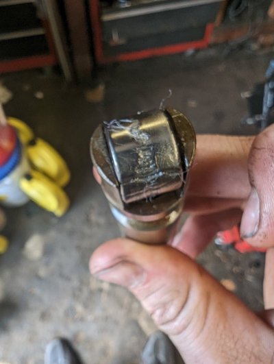

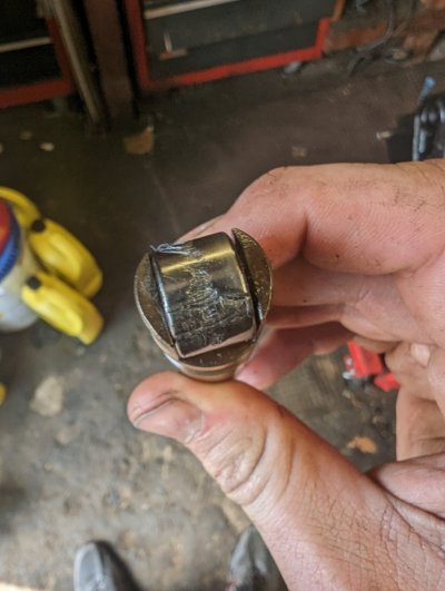

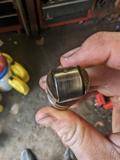

Here ya go 1 lifter like I suspected all others are good the roller is cracked and actively was falling off unfortunately cam is damaged just enough will have that our shortly cheaply made lifters.

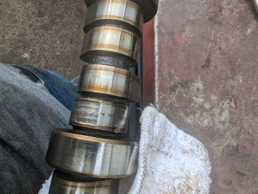

Yea its crazy how often this happens even on the newer rams I can tell the previous owner changed the oil on time aswell the motor is spotless inside. Here is the camshaft my truck says 3500 hours 1000 idle. PXL_20230404_194640779.jpg
