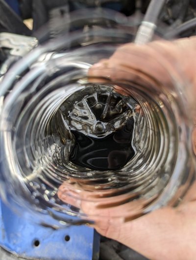

Now I know you guys Praise the 8 speed trans but at 114k why the FK should my trans fluid look like this... scares me bit looks worse then my 220k mile truck did. I had to replace the condenser so popped the trans lines ect no wonder it hums/girgles on startup........
If you replaced the condensor,you'll probably want to check the fluid level again after you've went for a drive and got the transmission up to temperature. The transmissions thermostat needs to open and circulate fluid through the cooler/condensor.,before you do a final fluid level check

Yea just ordered some oil $20 a qt yikes.. took it on first drive felt good I think i am going to change oil and filter due to how black it is watched some vids looks a little annoying but as long as i get pan level shouldnt be to bad i guess..
