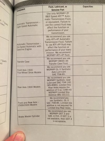

So this is odd, the top is a pic I took of the owners manual that came with my truck, and, the bottom is one from the online ram website for a '14 ram 1500/2500/3500. For 1500 they both appear to say 75w85 for front axle, but for 2500/3500 one says 75w85 and the other says 75w90. I wonder if they updated them or something.

Strange .... my 1500 2014 4x4 says 75W-90 front & 75W-140 for the rear ?
