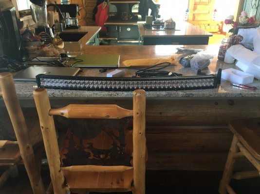

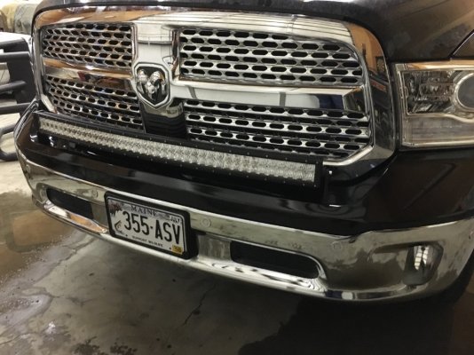

Here is my setup of a 42" bar. 64cd038b03d5748ce08e483864d3215f.jpgc01117e332dfb7e715ef2c9577edf002.jpge730790aa374466035064fb7abba3ce4.jpg
This is a 42" auxbeam combo 5d light bar. I purchased it from auxbeam for $170 and received it within a week. For 170 I am very impressed with it, my brother in law has a rigid and he said side by side he could not even tell that there was a difference... The light output is insane! I wired it to a on/off/on switch. One setting is just on when ever I want and the other is off the high beam. 5444323fb187b537f6d720e819b72464.jpg

I've been looking for someone to do this with our bumper types. I like it!

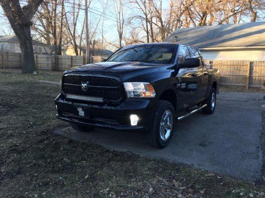

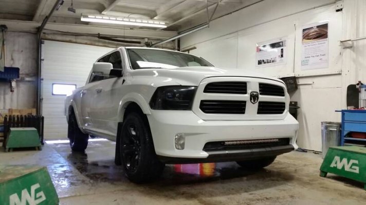

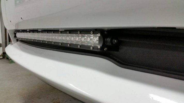

I mounted mine in the bumper (privilege of a sport) 30" single row I got off eBay.

How did you set your bar up with the 3 position switch? What did you use for a trigger to make it come on with your high beams? When I was digging through mine I was just gonna tap into the high beam wire coming off the bulb that I've done with previous trucks but this ram had a constant 5v, when off and 12v, when on.
Sent from my SM-G900W8 using Tapatalk
very nice... any night pics of her lit up?
That's the switch I used. And this is how I wired it 66e582f448485a13d86df37a5858fd8e.jpg

What/where did you tap into on the high beam circuit....?
I tapped into the positive wire running into the high beam bulb behind the dust cap. That was the easiest place because I had the headlight already out to put hids in.

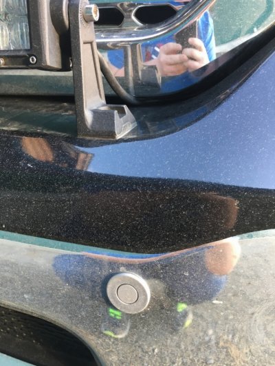

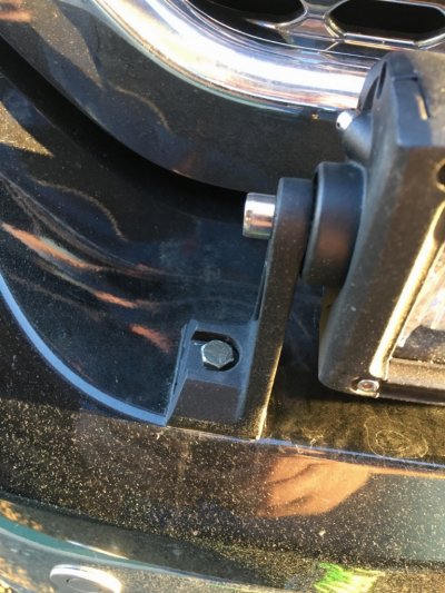

How did you mount the light bar to the bumper like that?
I have a Big Horn Edition with the same bumper style as you do and tow hooks as well. I have two Rigid Dually Spots I wanted to mount behind my grille but found out I can't due to active shutters. So I moved to the bumper idea and searched for literally days before I found this thread. So please share the secret!
Dirtbikekid1998
Dirtbikekid1998
Aug 8, 2015
165
135
Maine
2015 1500 Laramie Brilliant Black Crystal Pearl Coat
I just drilled all the way through the plastic and metal then just bolted it down. You might want to shim between the plastic and the metal bumper because there is a 1/4" gap between the plastic trim piece and the actual metal bumper, so when you tighten it down it pulls the plastic down. I've had it on for quite some time now and it hasn't loosed up or done anything to the plastic. b90f773459fc3a5c64f006b2d88cd90e.jpg61e40d23eff0c6f16f9172f3f67a427e.jpg
NewTruckGuy
Mar 14, 2016
I did see that gap when I was investigating ways to mount. How did you reach your hand under that metal bumer to tighten the nut down? I'm kinda worried about drilling into the metal but maybe I'll have too if I can't find another way. Thanks for the pics!
