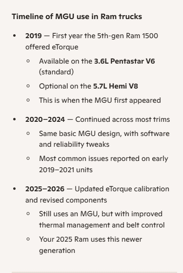

can't help you out, but, from what i'm reading in the forum, i'll do my best to stay away from e-torque whenever i purchase a new truck. Besides, the batteries alone are way too expensive.
I had 2 2019 1500s. One with and one without the etorque. The one with it, I sold it at 100k miles without any issues with the MGU. Maybe something has changed with the MGU design??
I've heard that Stellantis really went cheap on the new batteries they put in the 1500s, so maybe that is part of the issue as well? Maybe the battery got damaged a bit when it hit 8v before i could pull over and shut it down.

I am surprised that the dealer did not further investigate your eTorque system. When my truck is running I'm seeing 14.4V (reading in the cab, and measured at the battery terminals) telling me that all is working as expected. With yours at 12.9 to 13.1, and down to as low as 12.7V, you are barely replacing the energy you are consuming. I'd be back at the dealer demanding they find out what exactly is going on.

I had battery concerns with my new truck, which turns out were me just worrying for no reason. I would put a trickle/maintainer on the truck's battery and once it turned green, was fully charged I did check the voltage with a meter and inside the cab. 14.4V when running.

You had two rams one with eTorque, and you never came to any RAM forum til now? If you had, you would at least know about the issues with eTorque, a significant number of these fails renders the truck useless with no fix in sight, despite the majority who love it. Maybe a new battery fixes it, maybe not, but learn about your local lemon law process, usually 4 attempts to fix or 30 days in the shop, and if it is your e-torque you can bank it will be thirty days right out of the gate. Lemon law lawyers get a small % and the owner is made whole. Not much more to say, GL with it, don't take an ounce of cr@p from stellantis.

The original MGU might have never worked, I don't know how long a new battery would last with no charge from MGU or alt, but 600 miles sounds about right. Especially since it is a large battery yes?

Correct. I hear they are H7 batteries which are pretty large from what I understand. I haven't checked the CCA on the stock battery, but I'm assuming it would be around 750??
I agree, the original probably never worked from the get go.

This is what I've read as well. The Hemi and Pentastar engines use different etorque systems. So I wouldn't compare the behavior of them. It could cause you to chase something that's not a problem.

h7 is the original 5.7 battery, I do not believe that is the e torque, but don't know for sure. I actually don't think you would get 600 miles from an h7 with no charge.
