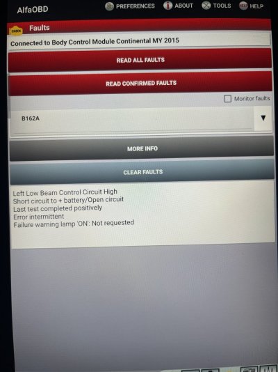

Ran back through all the settings, and I now have the fog lights functioning as the DRL’s!
I also checked for any faults before logging off alfaobd, and I’ve got 2 codes now with no CEL. Should I be concerned about these causing LED issues down the road? My test drive (about 30 miles) last night didn’t yield any problems with flickering, drop out, etc.
B162A and E
