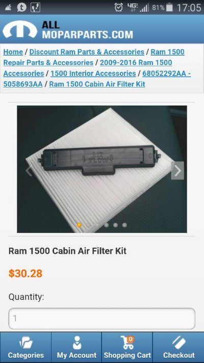

Not sure why the link above isn't working or thisone if it doesn't work but just Google :
www.allmoparparts.com follow the site appropriately and you'll find the kit for like $30 and there's a cool tutorial of the mod install .
Hope this helps !
