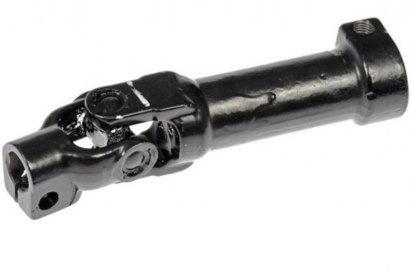

Check the u-joint on the shaft ,they are a known issue.

If I can chime in about Pep Boys when I initially replaced my EPS rack my alignment was slightly off and the steering wheel was crooked. I took it there as I paid for a lifetime alignment and when I got the truck back for some reason they loosened the 2 bolts that hold the rack in place. The car steering wheel was still crooked and now it drifted further to the right. I caught wind of this and informed them only to be asked to return and since it's not the first time they've made such egregious mistakes I decided to put my best effort to resolve it myself. Dealing with the current situation every place has limited hours, short staffed and parts are unavailable for a myriad of reasons. I got the car to steer correctly and the steering wheel remained crooked. The rack that I replaced in December of 2021 failed in June 2022, it was a Cardone 'remanufactured' unit. Considering this is a part that is integral to operation and safety perhaps it should be replaced/covered by warranty or some kind of class action lawsuit.
As for the stiffness you mentioned I figured out that the steering wheel and adjustment is handled with the steering u-joint. It's possible that yours may need lubrication or replacement. I'd advise sliding the boot back or attempting to fill it with lubricant. See if that loosens things up.
If you look under the break pedal you can inspect it and move it around to determine where the issue lies. The other is on the side is in the engine bay along the battery box and driver side wheel well. It has an upper (steering wheel link) & lower bolt (on EPS rack) that uses a metric 13 socket. I was able to disconnect it at the top to make the adjustments that allowed me to center the steering wheel, then on the tie rod ends I adjusted it as necessary to fix the alignment.
Certainly a mechanic would be best suited for this however, it's not terribly difficult to service.

I would start with this little guy.
It’s a likely culprit and much cheaper than a steering rack.

The welded joints on your new shaft probably were not aligned 100% on the steering shaft you installed. But truth be told, I doubt that even the best OEM steering intermediate shaft would be 100% the same as your truck's original steering. The steering tow needs to be re-set after an intermediate shaft replacement. It's easy to do ...as you have illustrated.
If you haven't done so, you might measure across the front of your tires ...front and rear. The front of the tires should be about 1/8" to 3/32 narrower than the rear (called tow-in). Just look up 'setting your car's tow' on youtube.
