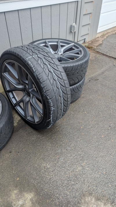

You are 5.2% smaller than current size, that will make it run faster, so you will probably be off more. Alpaobd can correct that easily
Look at the 3rd line on the calculator, the numbers in the parens are what has to be charged you are currently 2564, going to 2430.

yeah exactly thats why im tyring to get a lot of input
should i go with 1" taller tire?? id rather have the gap how it is currently, not a lot of gap

Go up to a 50 series
A 295/50R20 tire is 31.61 inches in diameter and 11.61 inches wide. The sidewall height is 5.81 inches.

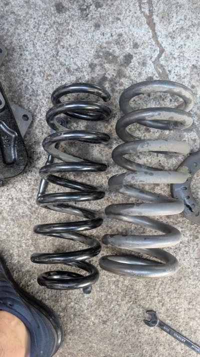

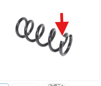

Well the spring don't seem to be right?
They are more narrow than the belltechs and don't fit into the cups

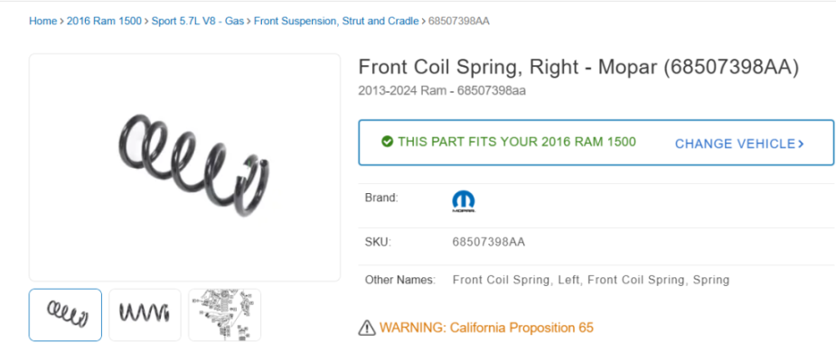

Connect with Benny here on the forum at all mopar parts. Give him your vin and he will tell you the replacement spring for your truck as I'm certain the oem is discontinued.

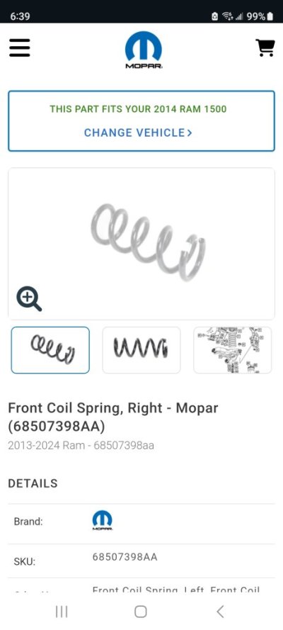

Here's the apparent replacement for your front springs
ORDER 2 OF 68507398AA
SAME SPRING IS USED ON LEFT AND RIGHT
SIDES. SALES CODE ZCE - LEFT FRONT
SALES CODE - ZRE RIGHT FRONT.

when i look up 68507398AA it says rear coil spring. lol

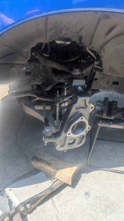

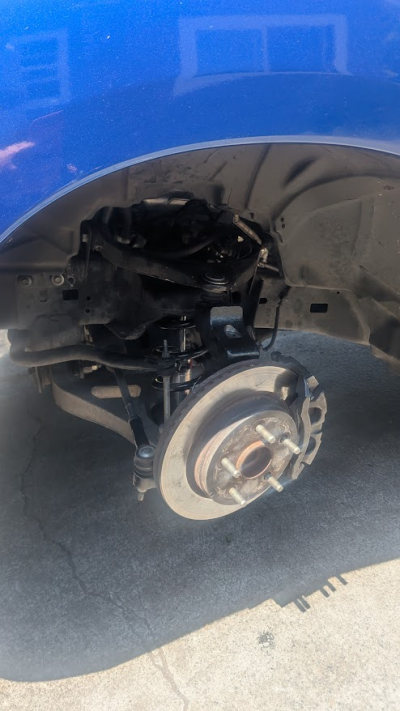

the new springs arrived and they are the correct ones.
i put them on, but the front rides higher than before now. the 2" springs and 2" drop spindles didn't have the equivalent result.
it looks like i will have to cut the front coils to achieve the height i want.
they're mildly a PITA to get in and out, just having to take off the shock... but general rule of thumb for these springs? 1 coil = 1"????????
id rather not have to take them apart a bunch of times, but obviously don't want to overdue it. should i try half a coil first?
also, camber is way off after swapping, if i have it aligned now will i have to have it done again if i lower it another 1"
