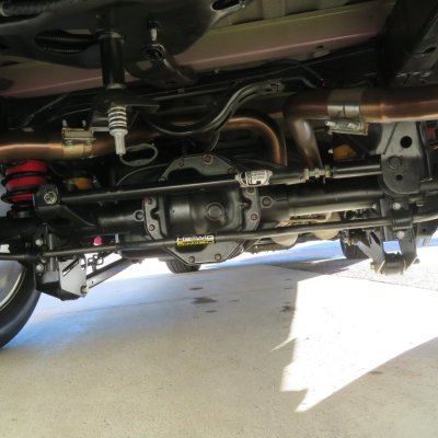

I was looking under the truck and I found this it must be hitting here still but only sometimes I guess
It looks like the sway bar hits the bolt for that track bar thing
If you redrill the hole on the frame side,you can get rid of that trouble prone bracket.

My 14 RT did the same thing. I had to remove the bolt, by taking the sway link down then raising the truck on the jack to allow access then put the bolt in from the other direction then reassemble everything. The bolt is too long and that is what is hitting. I also replaced the bracket holding the swaybar bushing and the bushing as mine had torn the bushing in half.
cool i will try this

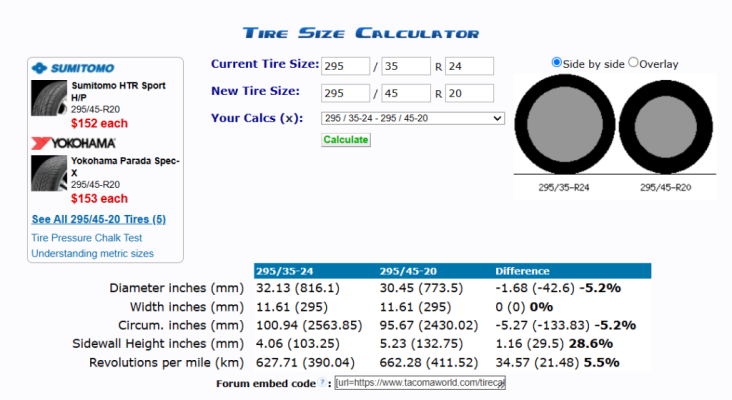

A 295/45R20 tire has an overall diameter of 30.45 inches and a width of 11.61 inches.
This is what I mean, is this what you want from a size standpoint. No worries on my part.

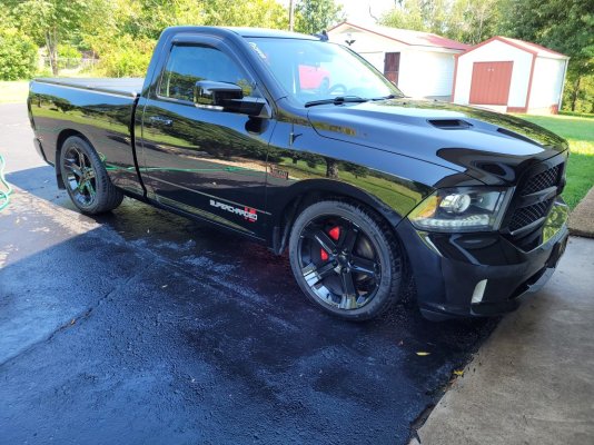

This is my RT with 32s in the rear 31s in the front.
cool
here is what i have currently compared to the new size:

i went out an measured my current setup and it was 31" tall. maybe from wear from tires?
maybe slightly higher than 31"

Tires compress slightly once weight is on them
You're fine. Tires are expensive just make certain they are what you want from a height standpoint.
