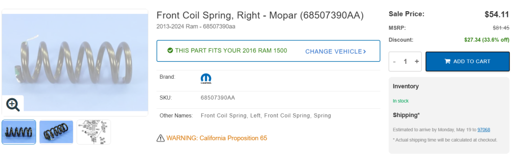

Looks like it says it fits your truck,and it looks like a front spring for a 2 wheel drive truck.
It's definitely not a front spring for a 4X4.
Post an actual link to the spring,for us guys to lazy to look it up ;)
try this link

I'd say if you can get it and the matching other side spring,you better buy them,as it looks like they're discontinued
the springs are different right to left??? thats crazy
all the links say coil spring right
Did you check with your local dealer for the springs,another option is to search your local wreckers / market place / craigslist for somebody parting out a 2 wheel drive truck.
Your local dealer should be able to source both springs,or tell you if they have differant part numbers

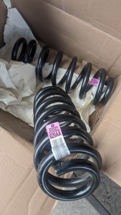

i'll see how these springs look first then maybe check
Isn't that the backasswards way of doing things,i think i'd check first beforehand,but that's only me.
You got an issue with going to your local dealers parts department,hell i drop into my local parts department fairly often and visit with them,even when i don't need anything.

Think I’d do the same as him if he got the springs for $5/each

But yea if you got the springs for 10 bucks,you're not out anything even if they're not right.
