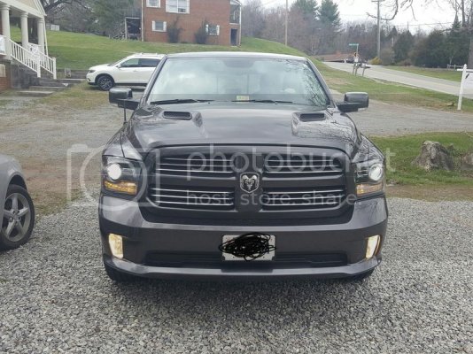

Just install TheRetroshop.net HID kit for the 2016 1500 sport, all i can say is WOW what a different. soo much light now, Took about 5 hrs to install, had to make a bracket for the can bus resistors to mount inside frame rail on Drivers side, then figure out where all the connections go, etc but way worth the time and effort. Need to install the fogs next but ran out of time. An after pic for you to enjoy. These are 5500k lamps.

Looks good. I had LEDs installed last Monday and one burn out on Friday. Took it back to the shop today and shop owner decided he was going to put in HIDs but he has to order them so I have to wait. I was wondering if you can take a pic to see how it looks from the front.

Front, Gotta get those fogs in now. make it all match.

Thanks. Can't wait to get mine put in. I was going to leave my fogs alone but I also might want to match them. Hopefully after I have the HIDs put in I won't have any more problems
