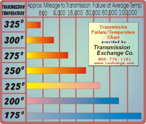

You always drive in tow haul? Redline c+ ester based fluid, takes heat better then oem atf4. Line one is oem, line 2 and 5 combo is what redline uses. Also really takes out harsh shifts when you change to redline c+, but sometimes just fresh fluid will do the same.Having said that, your trans is fine as far as temp goes. 175 is ideal temp.
