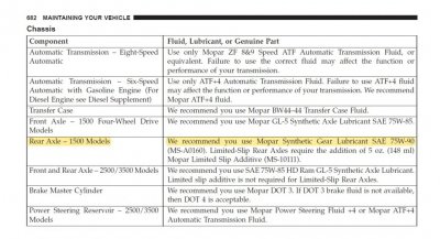

So I went to my dealership today to get fluids for the transfer case, front and rear differentials. The fluid that they gave me for the front differential and the transfer case match what the owner’s manual call for. However the owners manual calls for SAE 75W - 140 and 5 ozs of LSD additive for the rear diff. They looked up my vin and told me that the rear diff on my particular truck calls for SAE 75W - 90 and none of the additive. So who do I trust. The owners manual or the dealerships computer? This vehicle has a lifetime warranty that I don’t want to loose. Anybody have this issue?

I contacted a second dealership and the confirmed that the book is wrong...my rear diff calls for 75W-90.

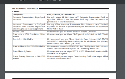

Something changed for whatever reason in 2017 in FCA calling out 75W-90 for the rear diff. My online PDF copy owners manual for my 2017 1500 calls out using 75W-90.

I looked on the Mopar site for my vehicle. There is two different links to the owners manual. One shows 75-80 and the other shows 75-140. Both with LSD addictive. Two dealerships say no additive. I sent a message to Ramcares to see what they say. Either way I’m waiting on a 14mm Hex...lets go Amazon.

Yep prob some MPG to be gained with the lighter weight fluid. It can't be bad when our big brothers can tow way heavier and they run 70w90. Lol. it seems the manuals were revised in 2017 and up. Same diff as far as I know. But Mopar now says 70w90 is fine for your rear diff. Lighter diff fluid should give you more mpg and possibly free up some ponies. If you don't tow heavy I don't think there should be any issues changing it. I used the heavy one cause I offroad often plus I have the factory clutch based LSD. Clutches run hotter compared to an open diff.

I heard back from RamCares...my rear diff does call for 70-90. Now waiting for them to tell me if it needs LSD additive. The dealership said it didn’t
