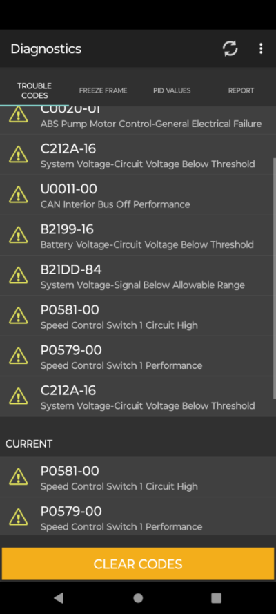

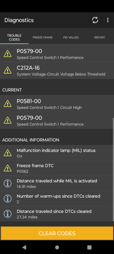

This started as an inquiry into whether my battery was dying due to the trailer 7 pin being attached. We'll I've disconnected everything and have been sitting here for a while. I've also made sure my inverter was off. However after maybe 5 min, the dash goes out and then a few min later it comes on again. I made sure the wheel for the dash lights is all the way off and my key is out. I tried to start my truck again and it was struggling as if the battery voltage was low. Also when I pulled codes, the only one there was for low battery voltage. If anyone has had this issue before let me know. This is a 2017 Ram 3500 Tradesman 6.4L V8

In that case it sounds like (and from reading your codes) you've got communication errors, meaning you've got a wiring harness that has issues. It's likely creating a short that is draining the battery.
I'm going to check if there's any messed up wires later. This is how it's started today, do I have a weak starter? I feel like that's what it sounds like.
