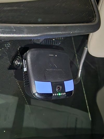

So I haven't noticed anything not working but oddly enough I've noticed stuff working overtime lol. My truck's dashboard lights stay on significantly after the key of out and truck is locked. Also there's this fleet monitoring thing that stays on aswell. Also do these trucks make noises after they shut off. Like mechanical switches? Mine makes a few switch noises after it's off. Don't know why, I've never had a car do that.
